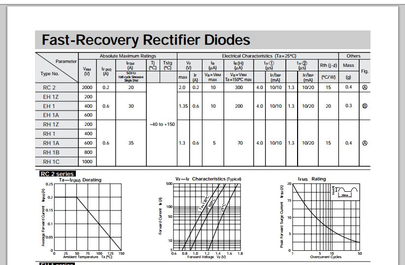

RH1Z=200V,0.6A

Re: Plantron 5180a
multumesc! merge foarte bine cu RGP15JANDRASONI scrie:RH1Z=200V,0.6A
